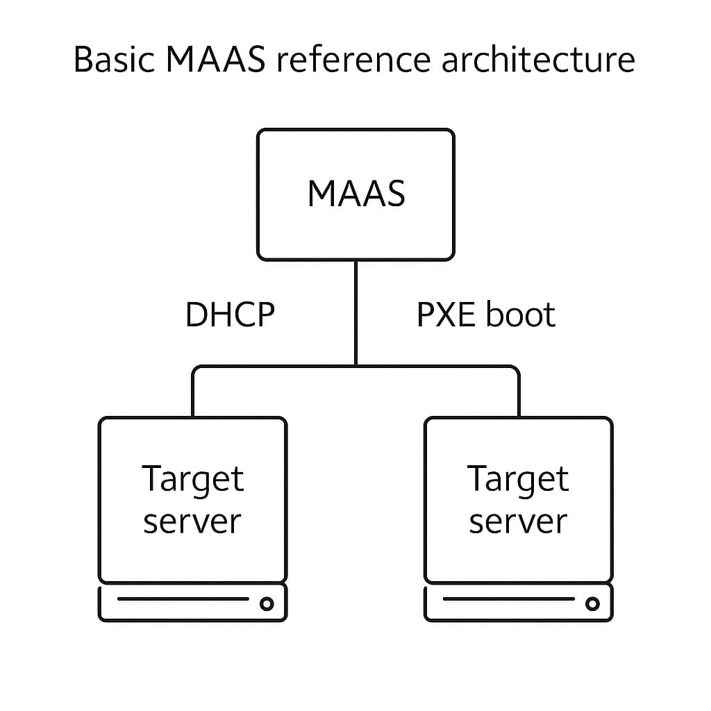

MAAS works by detecting servers that attempt to boot via a network (PXE booting). This means MAAS needs to be on the same network as the servers it will manage. At home or in an office, this can create conflicts with existing DHCP infrastructure, so we use a fully self-contained virtual setup instead.
A potential MAAS test setup

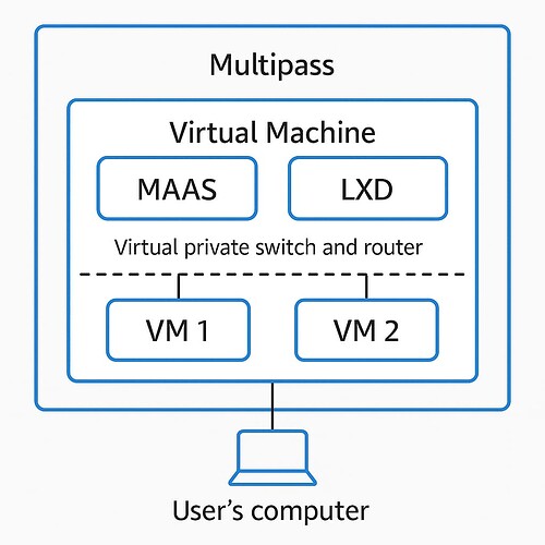

One way to try MAAS is to have a separate network with a switch, router, and several servers. One runs MAAS, the rest are targets for provisioning. In this tutorial, we automate all of this in a virtual machine with Multipass and use LXD to simulate machines MAAS can control. The setup looks something like this:
1. Setting up Multipass and launching the VM
Multipass is a Canonical tool that simplifies the creation of virtual machines. This tutorial uses Multipass to build a self-contained VM that hosts both MAAS and an LXD environment.
